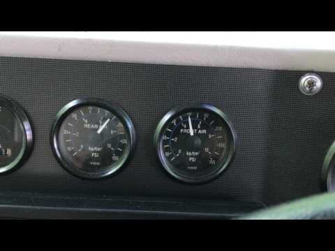

          Here's ours filling on a warm day.
