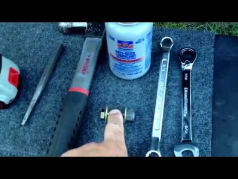

    OK steps are fixed, replaced three of the bushing/rivets and they are sturdy now. May need to replace a few more in the future but I'm confident it's very safe for a long time to come.
    Used 3/8" x 1.5" Grade 8 bolts with 5/16" washers (for some reason they were a better fit on the bolts) and Nylock locking nuts. The 1.5" had just enough shoulder so that it's not just threads that the step mechanisms are rotating on. On our step one of the bushings can't be replaced with a bolt because it has to slide under another piece when step is retracted so it needs to be a flush type rivet. Luckily that one is OK on ours but at some point I may have to figure out what to use to fix it.
    Stuff needed (besides the bolts):
    • 4" Angle grinder with cutoff wheel, any hand held grinder would probably work
    • Hammer
    • Punch
    • Drill with 3/8" metal bit
    • 2- 9/16" wrenches
    • Anti Seize or other grease type lubricant
    Check out the video I made:
    1992 Champion EuroPremier 38'-sold, 1984 Ford Bronco, 2010 Australian Shepherd - "Coby", 2012 Pomeranian- "Bella"
    www.ClassicRV.net
